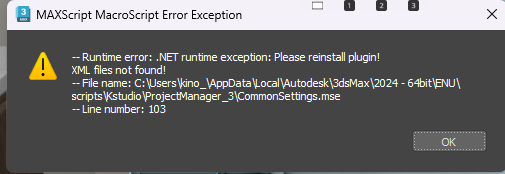

    I installed version 4 on Max 2024 and I can’t open it.
    I can’t uninstall version 4 and revert to version 3. Any solutions?

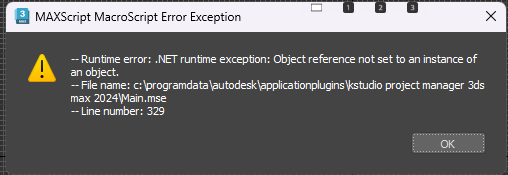

  • #47357
    Hi!
    Your database is certainly fine. That error wasn’t
    a data problem: the plugin just tried to open the database while it was
    still being updated in the background, and timed out. Nothing was damaged.
    I’ve prepared a new build that handles this situation gracefully
    (it now shows a clear message and closes instead of erroring). I’d recommend
    installing it — https://3d-kstudio.com/my-account/downloads/
    After installing, just reopen Project Manager.
    If the error comes back even after that, send me the log file so I can check
    exactly what happened (no rush, your data is safe and backed up):
    %LOCALAPPDATA%\Kstudio\data\logs\kstudio.log

    I installed version .50 and now I get this error
    • #47366
      Because you tried to run 3rd version.
      Restart 3ds Max and run version 4
