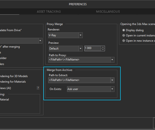

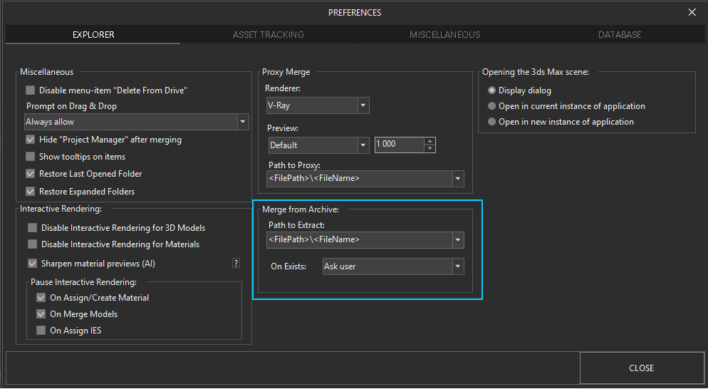

Where the files are extracted
Set it in Preferences → Explorer → Merge from Archive → Path to Extract:
  • <FilePath>\<FileName> (default) — a folder named after the archive, next to the archive.
  • <FilePath>\Archives\<FileName> — the same, but inside an Archives subfolder next to the archive.
  • <Temp> — a temporary folder. Only the files you merge are extracted, and they are always overwritten. In this mode you can merge 3D models only.
  • Your own path — type any folder with a drive letter, for example D:\Extracted\<FileName>. 3ds Max project paths such as <ProjectFolder>\Archives\<FileName> work too. Keep <FileName> in the path so that every archive gets its own folder.
With any path other than <Temp>, Project Manager extracts everything next to the model in the archive, so its textures come along.
When the file already exists
Choose what happens in On Exists: Skip if exists, Overwrite if newer, Always overwrite or Ask user.
Choose where files from archives are extracted and what happens when a file already exists — Preferences → Explorer → Merge from Archive.
