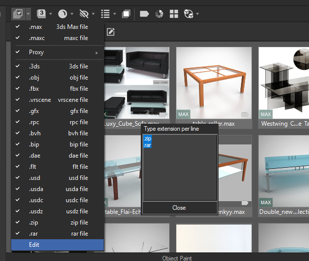

Previews next to RAR files. Yes, this works. Project Manager can classify and search archived models so they’re classified from those previews. Add .rar (and .zip and .7z, if you use them) to the list of model file types: open the “Filter by file-type” dropdown and choose Edit.
The archives are then shown in the Models tab and treated like any other model, so they’re classified from the preview images next to them and become searchable with AI Text Search and Find Similar.
