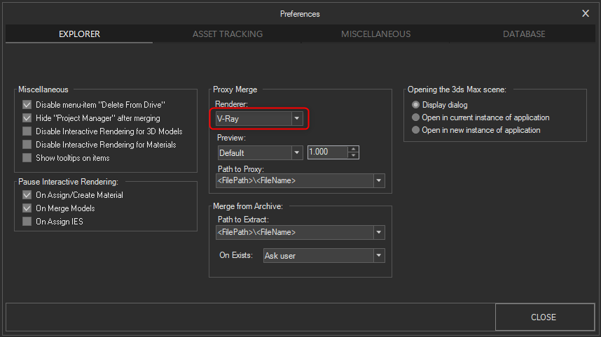

    Hi Oleksandr,
    A doubt about Customize–Preferences.  I would like to know how to set the Arnold render engine as the default in the preferences, since every time I change it and reopen Customize, it automatically switches back to V-Ray.
    Thanks.
    Plugin version: 3.41.07
    3ds Max version: 3Ds Max 2024
    Renderer: Arnold
  • #45612
    These are the settings for the proxy.
    Project Manager uses these settings when converting models to proxies.
  • #45615
    Sergio Alonso Ávila
    Posts: 12
    Threads: 31
    Joined: Sep 2025
    Okey , but what if I don`t have the V -Ray engine and I just want to use the Arnold one?
    Is that possible by any chance?
  • #45616
    Set up any renderer you prefer as the default using the standard 3ds Max Render Setup dialog.
    By default, Project Manager merges models as proxies and automatically creates texture maps and materials supported by your active renderer.
    This means, what in the most cases, you don’t need to adjust any additional settings.
