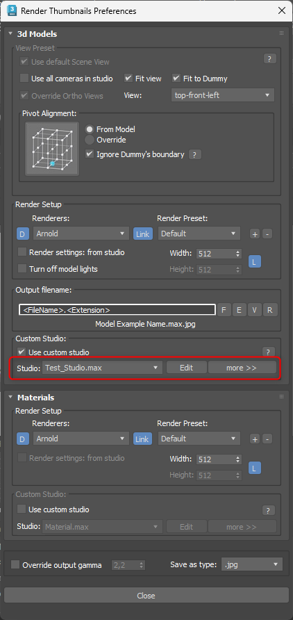

Im trying to create the thumbnails of a big library . I have also created a customized scene to generate the thumbnails from that project. The issue is that everything is already linked, or so it seems, but when I click on “Generate Thumbnail,” it starts to generate it and I can’t see it. I have also disabled filters, and I don’t know what else to try.
How can I fix this or what else am I missing?

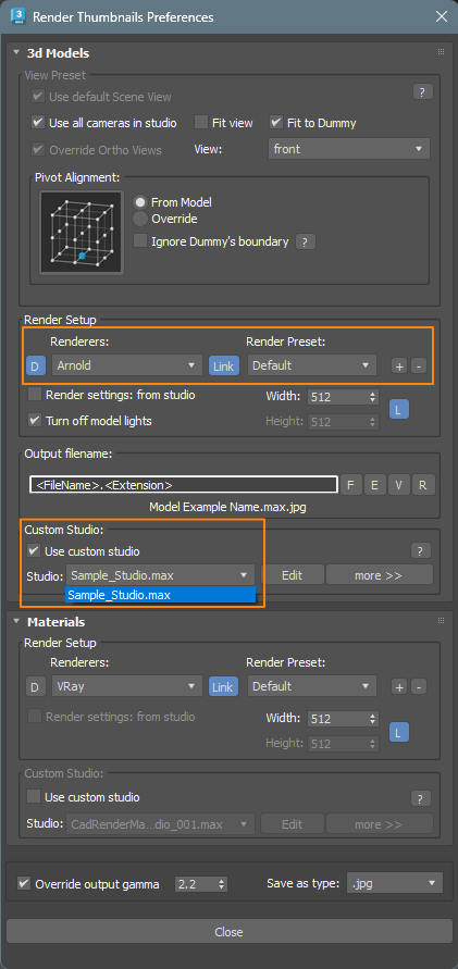

Oleksandr KramerModeratorPosts: 269Threads: 1413Joined: Aug 2009Try to switch to default studio “Sample_studio”.
It looks like a problem with your studio.
I checked rendering in Max 2024 with the latest version of Arnold and all works. - September 16, 2025 at 15:10 #45650

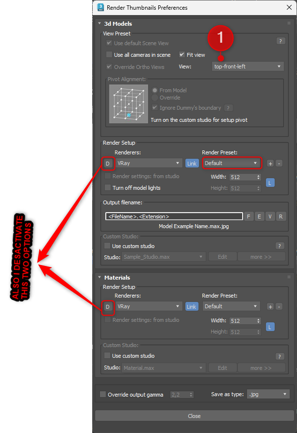

Sergio Alonso ÁvilaParticipantPosts: 12Threads: 31Joined: Sep 2025Thanks for your replies Oleksandr,
(1) Allright I changed it and it works now but just with the V-Ray settings and I want to generate these thumbnails with the Arnold engine and I still dont know how to switch that. (2) When I change it to Arnold it processes the render but does not generate it for me. (3) I already try to get on the . max of some pieces of furniture and change the Default renderer from there too but nothing seems to work.

Oleksandr KramerModeratorPosts: 269Threads: 1413Joined: Aug 2009Keep Arnold as default renderer. Just change Studio to “Sample_studio”.
The default settings will allow you to check if there is any problem at all.Also check the logs – open maxscriptlistener(F11) after rendering and check what is written there.
Also check if you have not disabled renderview display globally
- September 17, 2025 at 10:45 #45662
Sergio Alonso ÁvilaParticipantPosts: 12Threads: 31Joined: Sep 2025Okay thanks ! Now it works and I understand more how it works.

Read description near the custom studio (just press the “?”) and follow instructions to make your studio compatible.
- September 17, 2025 at 11:26 #45664
Sergio Alonso ÁvilaParticipantPosts: 12Threads: 31Joined: Sep 2025Fine, I will check it out too!
Maybe its something that is missing in the Test_studio.max scene.
