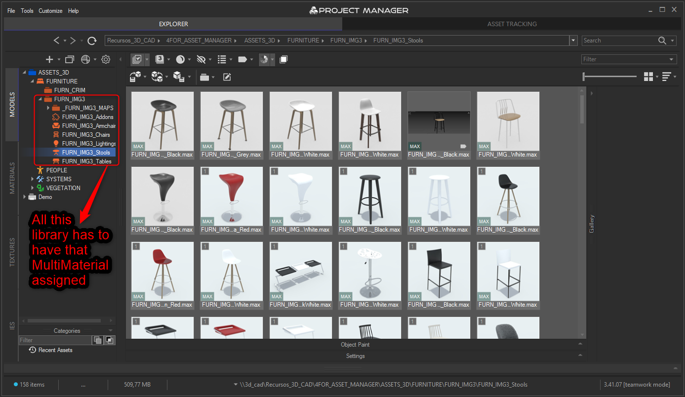

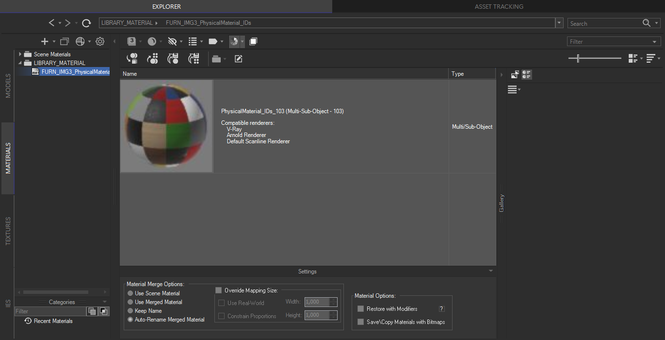

    Is there a possibilitty to directly assign a material (in this case its a MultiMaterial) to all of the assets from a determinated library inside Project Manager?
    Example: I got this MultiMaterial
    Can I assign it to this entire libary?

    There’s no built-in option for assigning a material (such as a MultiMaterial) to all assets in a specific library inside Project Manager.
    However, you can use the Project Manager MaxScript API to create your own scripts or tools with this functionality:
    https://3d-kstudio.com/faq-cat/maxscript-api/
    If you prefer, we can also develop such an extension for you. In that case, please send us a short description of the desired functionality and interface to support@3d-kstudio.com — we’ll estimate the required time and cost.
