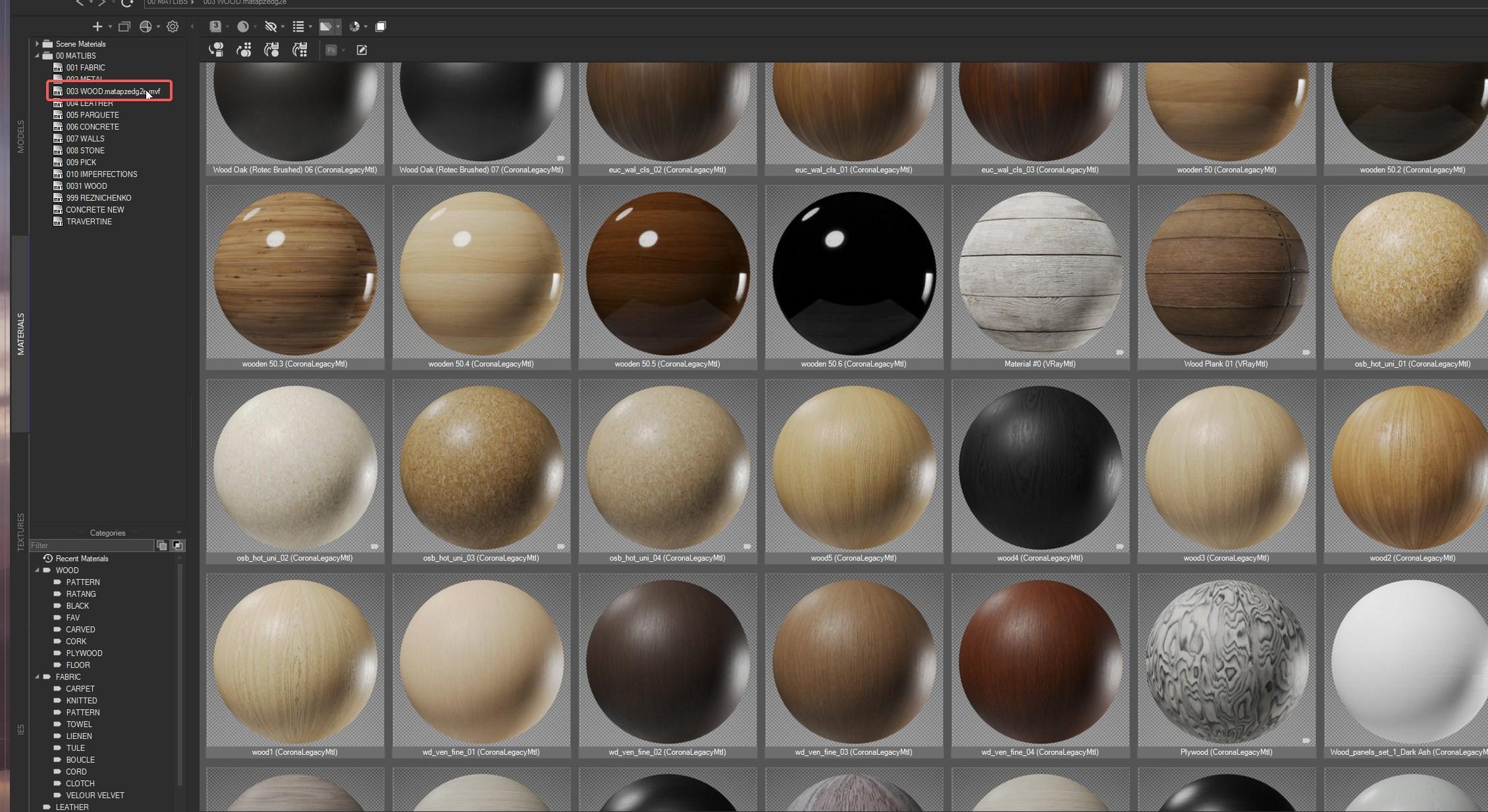

    Im trying to sort my materials with categories, and in a random moment my library changing its name, an all my tags are gone.
    I switched back from last version of PM to 3.43.10 because i thought that the problem in PM version, bu  it happens every time in every version i ve tried.

    Thank you for the detailed report!
    This is a known bug that was introduced in version 3.43.08 and has since been fixed.
    Please update to version 3.43.18 to resolve the issue.
    You can download the latest version directly from your account dashboard: https://3d-kstudio.com/my-account/downloads/
    Alternatively, the auto-updater will prompt you within a few days, provided no critical issues are found in the meantime.
