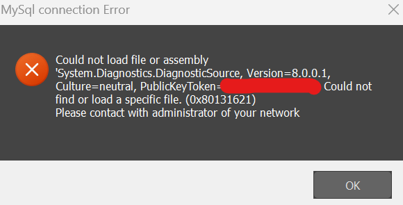

    I thought you said this was backwards compatible?
    Plugin version: 4.00.21
    3ds Max version: 2026

    2026-06-16 17:46:01.6282|Error| System.IO.FileLoadException: Could not load file or assembly ‘System.Diagnostics.DiagnosticSource, Version=8.0.0.1, Culture=neutral, PublicKeyToken=cc7b13ffcd2ddd51’. Could not find or load a specific file. (0x80131621)
    File name: ‘System.Diagnostics.DiagnosticSource, Version=8.0.0.1, Culture=neutral, PublicKeyToken=cc7b13ffcd2ddd51’
    —> System.IO.FileLoadException: Could not load file or assembly ‘System.Diagnostics.DiagnosticSource, Version=9.0.0.3, Culture=neutral, PublicKeyToken=cc7b13ffcd2ddd51’.
    at System.Runtime.Loader.AssemblyLoadContext.<LoadFromPath>g____PInvoke|5_0(IntPtr __ptrNativeAssemblyBinder_native, UInt16* __ilPath_native, UInt16* __niPath_native, ObjectHandleOnStack __retAssembly_native)
    at System.Runtime.Loader.AssemblyLoadContext.LoadFromAssemblyPath(String assemblyPath)
    at System.Reflection.Assembly.LoadFrom(String assemblyFile)
    at System.Reflection.Assembly.LoadFromResolveHandler(Object sender, ResolveEventArgs args)
    at System.Runtime.Loader.AssemblyLoadContext.InvokeResolveEvent(ResolveEventHandler eventHandler, RuntimeAssembly assembly, String name)
    at MySqlConnector.MySqlConnection.OpenAsync(Nullable`1 ioBehavior, CancellationToken cancellationToken)
    at System.Runtime.CompilerServices.AsyncMethodBuilderCore.Start[TStateMachine](TStateMachine& stateMachine)
    at MySqlConnector.MySqlConnection.Open() in /_/src/MySqlConnector/MySqlConnection.cs:line 517
    at KstudioDb.Core.Connectors.MySqlConnector..ctor(String host, String port, String user, String password, String database, Boolean silent)

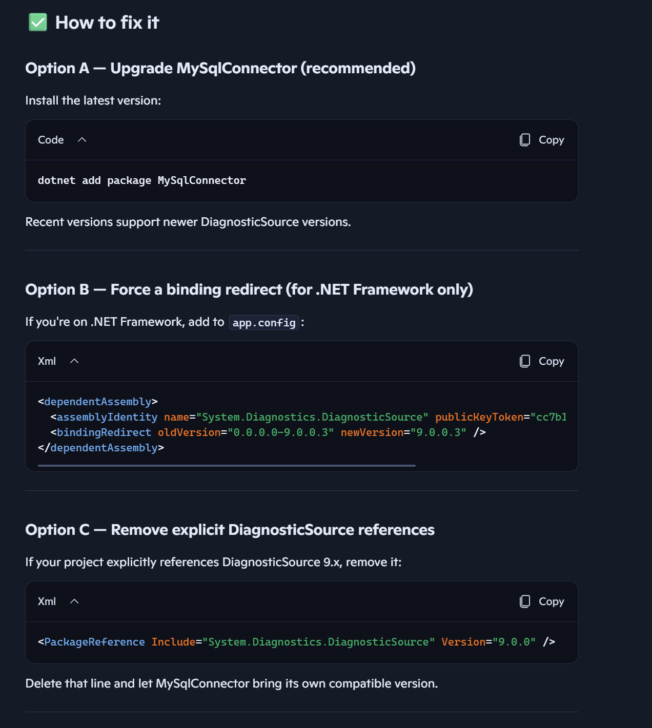

    AI:
    Got it — now everything makes sense. Kstudio Project Manager inside 3ds Max is a .NET application, and that application is the one failing to load the correct DiagnosticSource assembly. You don’t have access to its .csproj because you didn’t build it — Kstudio did.
    So the key point:
    ⭐ This is not your project.
    ⭐ This is a bug or version mismatch inside Kstudio Project Manager itself.
    You cannot fix this by editing a .csproj because you don’t have the source code.
    Let’s break down what’s happening and what you can do.

    Kstudio Project Manager uses the MySqlConnector NuGet package internally. Your error shows:
    It expects DiagnosticSource 8.0.0.1
    But your system (or 3ds Max environment) loads DiagnosticSource 9.0.0.3
    The versions are incompatible → MySqlConnector crashes → database connection fails
    This happens when:
    Kstudio Project Manager was built for .NET 8
    But it’s running inside an environment that includes .NET 9 assemblies
    3ds Max 2025+ ships with newer .NET runtimes
    Or another plugin installed a newer DiagnosticSource DLL into Max’s plugin folders
    This is a dependency collision inside 3ds Max’s plugin environment.
  • #47317
    Gethin Hooper
    Posts: 19
    Threads: 28
    Joined: Jun 2019
    🧨 Why you can’t fix it by yourself
    Because:
    You cannot update MySqlConnector inside Kstudio Project Manager
    You cannot change its DiagnosticSource dependency
    You cannot rebuild the plugin
    You cannot modify 3ds Max’s internal .NET runtime
    This is 100% on Kstudio to fix.
