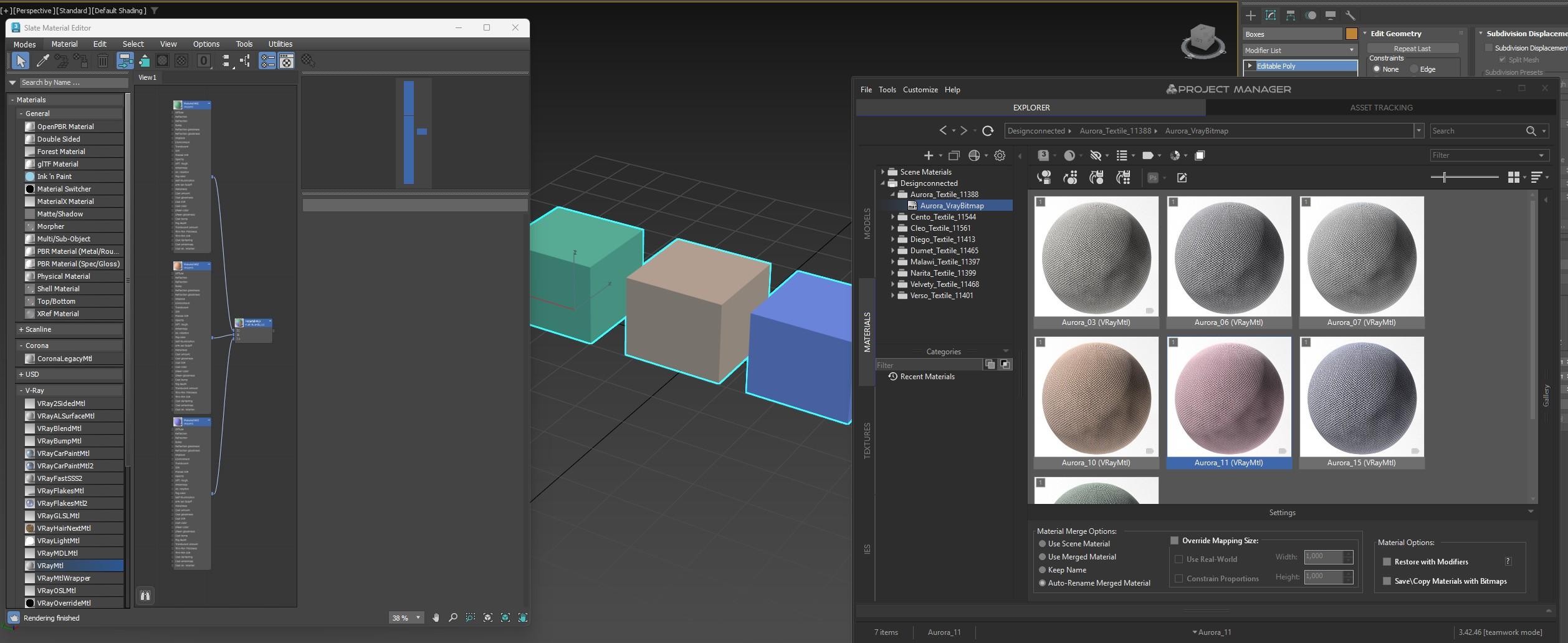

    To clearify here is an example:
    • One object with three elements.
    • Each element has a different MaterialID.
    • The object has a Multi-SubMaterial with 3 Materials.
    DragDrop
    When I drag and drop a material from project manager onto the blue cube (MatID=3), it assigns this material to the whole object.
    Instead it should only replace the Material in the Multi-SubMaterial Slot 3 with the new one.
    From your discription it sounds like this should work.
    Cheers
