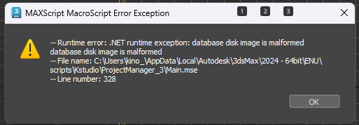

    It’s been happening to me since version 3.40.02.
    I’ve tried uninstalling and also trying older versions, but the problem persists.
    I’ve also tried deleting the database, but that doesn’t work.
    I’ve also tried uninstalling and installing with a clean install, but that doesn’t resolve the issue either.

    This is not related to the new version.
    This problem and its solution are described here.
    https://3d-kstudio.com/forum/project-manager-support/roject-manager-did-not-start-today/#post-44917

    Okay, what I did was delete all the files AssetSQLiteCache.db
    thanks
