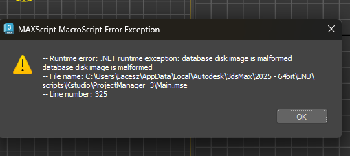

    Today the project manager did not start. I checked all the files are in place. What could be the problem? Should I reinstall the manager?
    Plugin version: latest
    3ds Max version: 2055

    The error you’re seeing:
    “.NET runtime exception: database disk image is malformed”
    indicates that the local SQLite database used by Project Manager has become corrupted. This is a known SQLite error that usually occurs when the file is unexpectedly modified or accessed improperly.
    > ✅ You do not need to reinstall Project Manager.
    🛠 How to Fix It:
    1. Launch 3ds Max, then go to Project Manager > Preferences > Database tab.
    2. Click the “Restore Database” button.
    This will rebuild the damaged database while preserving as much data as possible.
    3. If you want to preserve a copy of the corrupted file for recovery:
    Go to:
    C:\Users\Lacesz\AppData\Local\Autodesk\3dsMax\2025 – 64bit\ENU\scripts\Kstudio\ProjectManager_3\
    Rename any .db file (e.g. settings_corrupted.db) before restoring.
    ⚠ Possible Cause
    One common cause of this error is trying to share a SQLite database across multiple computers simultaneously (e.g. placing the .db file on a network share or syncing it via Dropbox/OneDrive).
    > SQLite is not designed for concurrent access from multiple machines – doing so can easily lead to corruption.
    If you need to use a shared database across a team, we highly recommend switching to MySQL, which is supported in Project Manager and is specifically built for multi-user environments.
