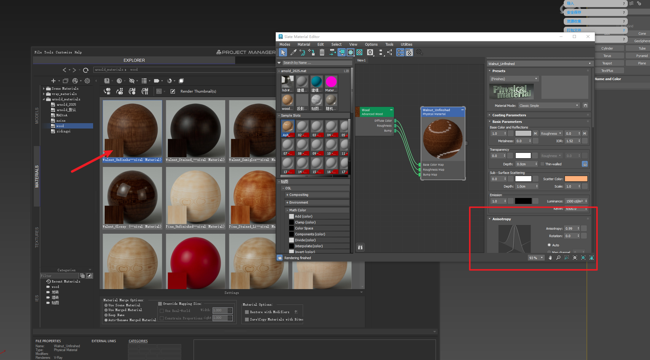

15810142059aParticipantPosts: 3Threads: 9Joined: Mar 2025When I copy or cut a physical material from one material library in the plugin to another material library within the same plugin, the anisotropy parameter changes unexpectedly from 0 to 1. Please fix this issue.

Oleksandr KramerModeratorPosts: 269Threads: 1413Joined: Aug 2009Please specify the plugin and 3ds max version and send this material to me.

15810142059aParticipantPosts: 3Threads: 9Joined: Mar 20253dmax2025,plugin 3.42.4
The document: https://1drv.ms/u/c/1cc8cdfe98bc16b0/IQCtRMUHDjmoQo5b_Ttt9Nq2AfoPGGUDGGD9bjdYxTu0h6c?e=38X9vN

Oleksandr KramerModeratorPosts: 269Threads: 1413Joined: Aug 2009Thanks for sharing.
I downloaded the first document, but can’t download the second (https://drive.google.com/file/d/1kGQVOAWftl5suL3YeKINjTYJED-KbD8P/view?usp=sharing)
- February 2, 2026 at 17:00 #46499
15810142059aParticipantPosts: 3Threads: 9Joined: Mar 2025The two documents are exactly the same. One of them can be downloaded directly.
- February 2, 2026 at 17:01 #46500
Oleksandr KramerModeratorPosts: 269Threads: 1413Joined: Aug 2009This issue is fixed in version 3.42.47
Thanks for your feedback! - February 2, 2026 at 17:56 #46501
15810142059aParticipantPosts: 3Threads: 9Joined: Mar 2025Cheers! Well done!
