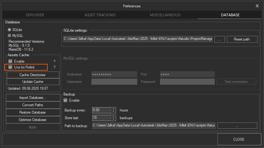

    Hi, I’ve used other versions of Project Manager, but I can’t seem to do it now. I only want it to search for the scene images in the “search directories” folders I’ve created where I’ve placed all the scene textures, and not search for them anywhere else. Thanks.

    I’m having a similar issue. For me it freezes the 3d Max and never comes back after I introduce the Directories i want it to search for and hit start in the Search&Re-link option. This is the first time this is happening to me. It used to work perfectly in all other versions before. I’m an long term Project Manager User.
    • #44971
      Version 3.39.03 receives the option to disable use cached directories for searching.
      Turn off it to search only in the specified directories.
