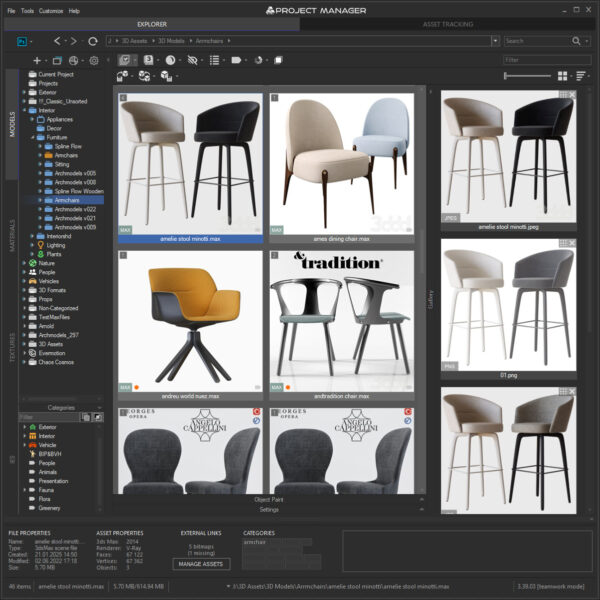

    Perhaps, its most unique feature – there is the ability to assign custom previews to materials, associate files with materials, and create a gallery of files associated with any type of assets including materials. You can also write a description for material and, of course, add materials to favorites.
    Project Manager - 3rd version with a lot of innovations
    Working with files
    Files Gallery
    The possibility to attach files to any type of asset, creating linked galleries.
    Materials are also supported.
    The first image in the gallery is used as a preview for the file.
    Use “drag & drop” to change the file position in the gallery.
    When rendering a preview from Project Manager or Batch Render & Relink, images are automatically added to the gallery of the file.
    Also, a proxy file that created when you merge the model is automatically added to the gallery.
    You can associate multiple proxy files with one model file. Below you can find the information about path settings for proxy.
    You can drag assets directly from the gallery to the viewport.
    Now any types of assets, including materials, support the gallery, can be added to favorites and contain a description.
