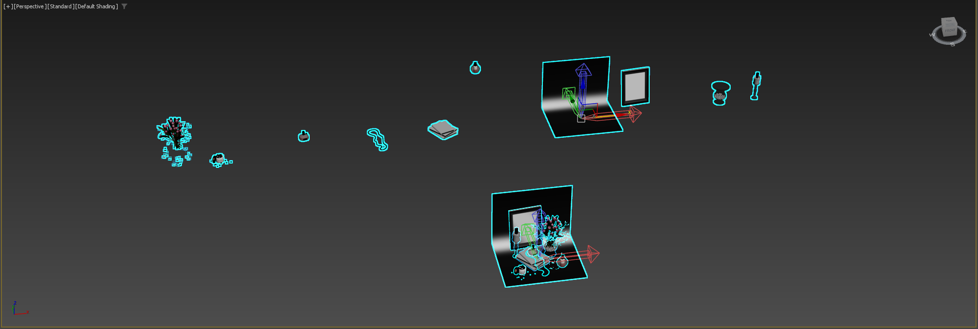

    We have broken down the asset sets into elements and exported them as separate objects, so that each object aligns to the common pivot point of the group. If we select the elements and drag them in or load them from the project manager, how do we get the result that all the assets are loaded into one place based on the pivot points? Is there a setting or idea for this?
    It would be nice if we could insert multiple assets at once by selecting them and dragging the first one where we want to place the pivot point, and the rest will be inserted in such a way that each of their pivot points is aligned to the first one. This way the group will remain together if the pivot points of the group elements have already been aligned to a common pivot point. Is it possible to insert or drag the assets in this way?
    Thanks Tom
  • #45258
    To place the models in their original position, use double-click to import.
    Simply double-click on the file and it will be imported and placed in the exact same location as it was saved.
    In the future, you will be able to import multiple selected files using this button.
    Currently, only the first selected file is supported for import
