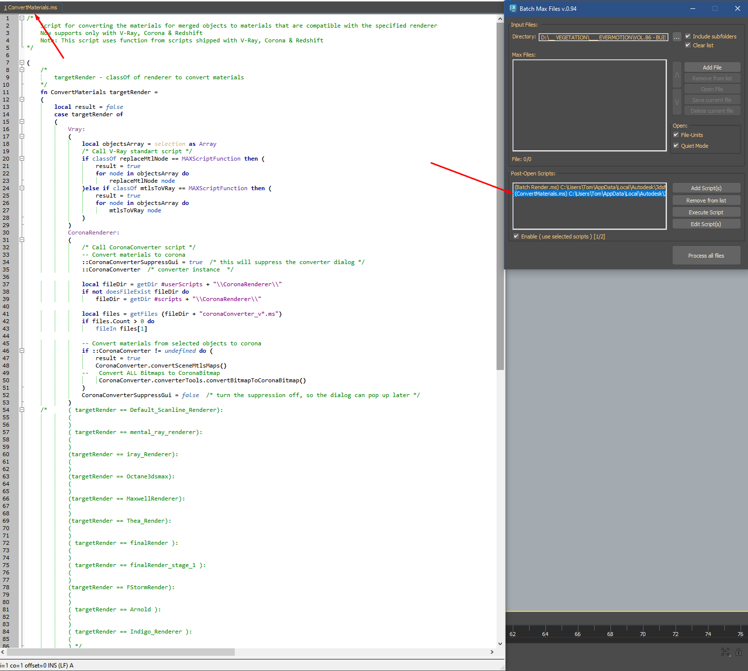

    Sorry, I don’t understand: why using a Corona script?
    I installed Trackscripts, and I choose to run ‘ConvertMaterials.ms’ (please see attached screenshot): isn’t this script intended to do precisely what I want?

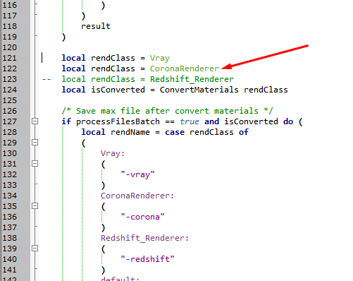

  • #44783
    local rendClass = Vray
    — local rendClass = CoronaRenderer // Uncomment this line in the script (remove “—“) and save
  • #44788
    Thomas C
    Posts: 19
    Threads: 47
    Joined: Mar 2022
    Thanks, I did.
    But it still doesn’t work.
    And this time no new .max file is created, possibly indicating that no convert process happened.

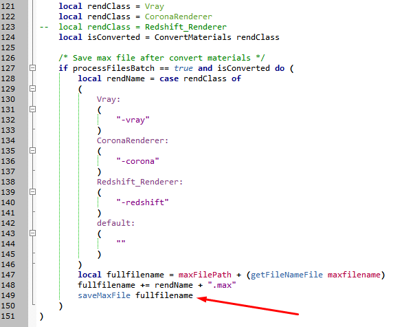

  • #44789
    Of course, you should add a few lines to save files after converting
  • #44790
    Thomas C
    Posts: 19
    Threads: 47
    Joined: Mar 2022
    Thanks.
    Sorry but I don’t know how to do that.
    I thought this is what this line does:
  • #44798
    You’re right – this script already saving file.
    It seems coronaConverter script is not found.
    You can try to find this file and specify it in the script
    if files.Count > 0 do
    fileIn files[1]
    if files.Count == 0 do
    fileIn @”path to coronaConverter_v…“
  • #44799
    Note that “processFilesBatch == true” means that the script will only run if you click the “Process all files” button.
    “isConverted” – means that function “ConvertMaterials rendClass” executed succesfully
