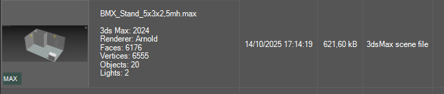

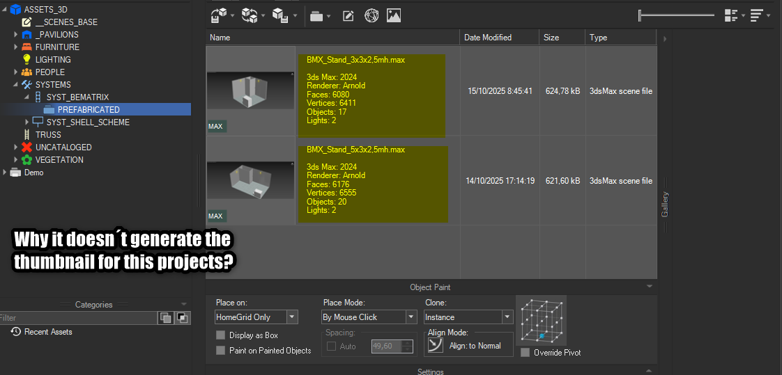

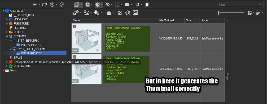

    Hi Oleksandr,
    I have a doubt about the Thumbnail generator. Basically I need to understand why whit some .max projects it doesn´t generate it.
    Is there like some minimal thing that have to be inside the project like the Sample. max scene ? (dummy, camera, light, etc..)  Example:
    Plugin version: 3.41.20
    3ds Max version: 3ds Max 2024
    Renderer: Arnold

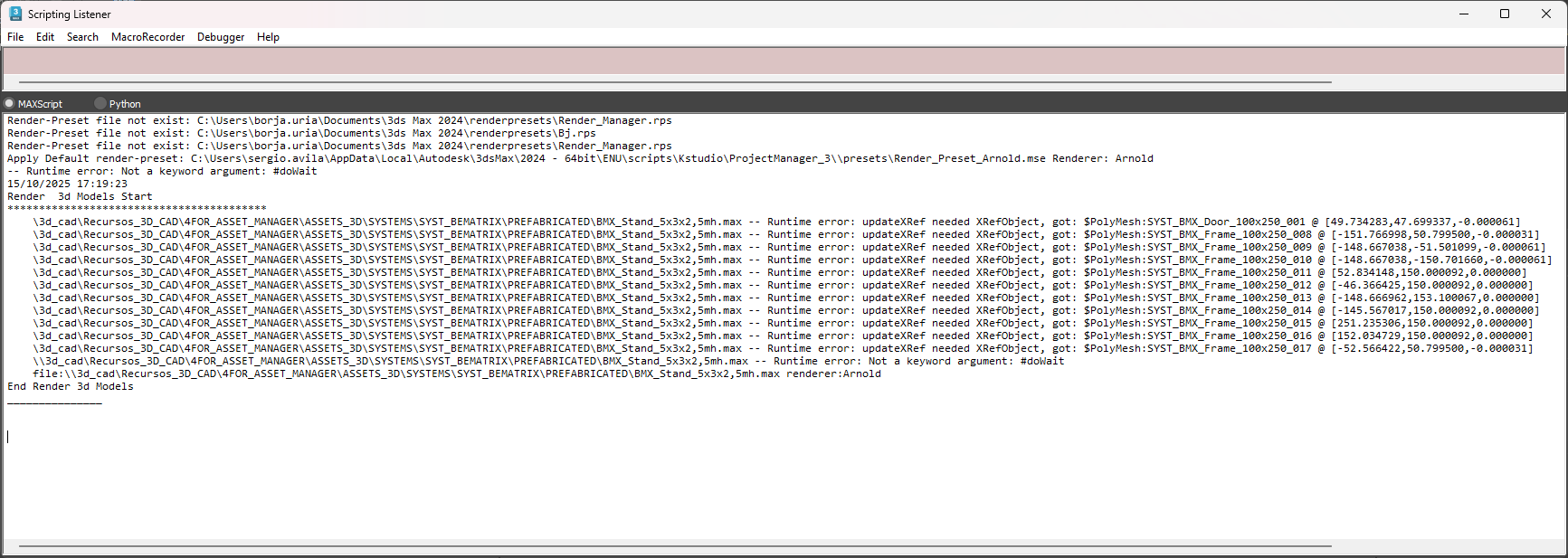

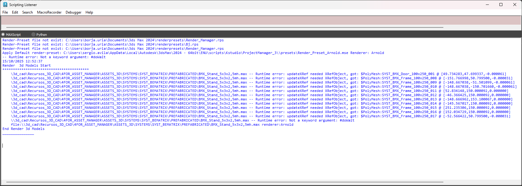

    Yes, you understand it right. The theme is that it looks like is trying to create it but when it finishes the process it doesn´t generate the thumbnail.
    Here is what is shown in the MaxScript Listener when I try to generate the thumbnail of this project:

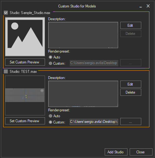

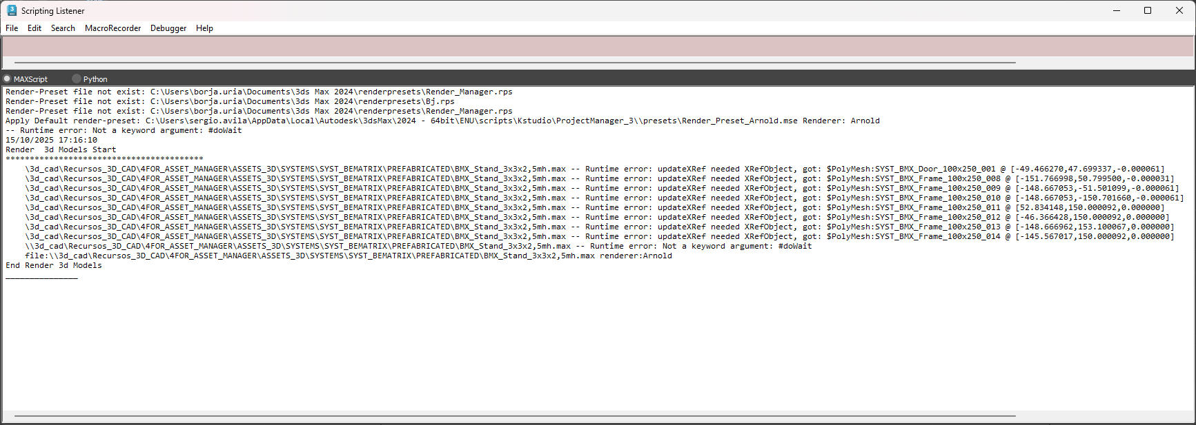

    Hi again Oleksandr,

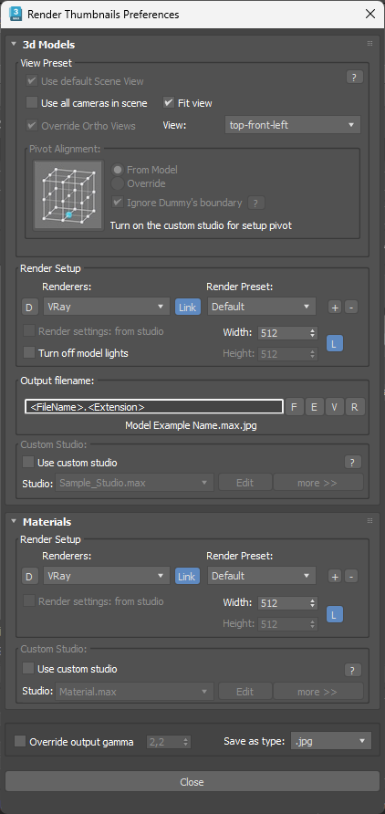

    Here is my Thumbnail configuration which I think is the default one . I also add some screenshot from the Maxscript Listener of what is happening when I try to generate the thumbnail of both projects. It doesn´t show me more information when I press F11 or maybe I´m not doing it right.
