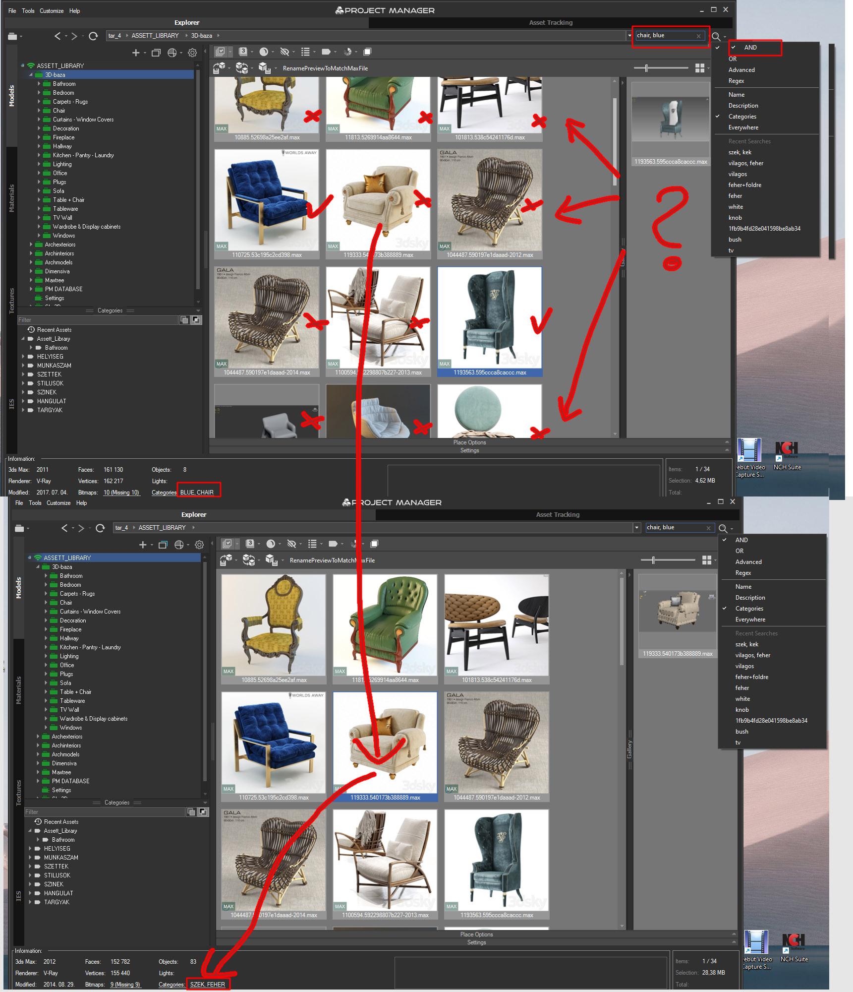

    The search also throws out items that do not contain the tag. What could be the reason for this?

    You’re right, this is a bug. I’ll fix it with the next update. This occurs when you’re searching using only a category filter
