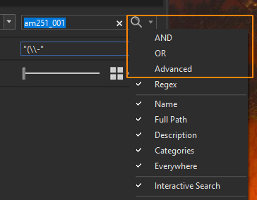

    Updated to the latest version and trying the interactive search but seems to be an issue with the search function or we are using it incorrectly. If I enter 3 letters of a keyword its almost instant, however If I enter a 4th letter it resets and takes over 2 minutes.
    Also is there anyway to know if the asset cache has been fully updated to the new search system?

    Version 3.40.28 requires MySQL version 9.1.0. You currently use version 8.0.28. Using not recommended version may extremely slow down searching. Please update MySQL to the latest version.
    Also, regex searching might be a bit slowly than other searching methods.
    Just switch to another search method
    …error when accidently entering incorrect characters into the searchbar…
    This will be fixed soon.
