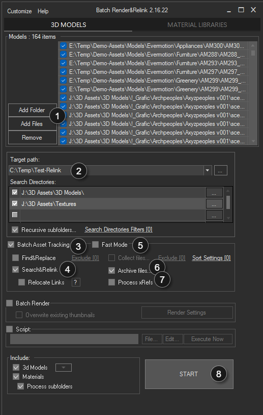

Just run the “Batch Render&Relink*”, add a folder (folders) or some 3ds Max files or a material library, specify the folder where you want the data stored, and shortly you will have all the archives ready.
*Applicable to the 3ds Max utility “Batch Render&Relink” and Windows application “Batch Relink” The utility “Batch Render&Relink” which shipped with Project Manager and FilePathFinder PRO. Also, you can acquire “Batch Render&Relink” as a separate tool
  1. Add files/directories for archiving 3d files with assets
  2. Specify the path to store archives (supports full and relative paths)
  3. Turn on the Batch Asset Tracking option
  4. Turn on the Search&Relink option (optionally)
  5. Turn on the Fast Mode (recommended, optionally)
  6. Turn on the Archive files
  7. Turn on the Process xRefs (recommended, optionally)
  8. Run the process by pressing the START button
Batch Archive 3ds Max files and Material Libraries with all assets
The archives will, of course, contain the source files for the scenes and materials. When opening a scene from the archive on another computer, all links will remain valid, because the links during archiving are made using relative paths.
Before archiving, you can use Search&Relink option to search for missing links, if necessary.
Batch Render&Relink- Search&Relink
For the target folder, you can specify both full and relative paths. For the latter, use <FilePath> and <FileName> masks.
Batch Archive - Full & Relative paths
