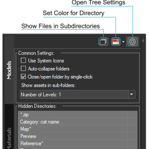

You can display assets from several directories or categories simultaneously, using the “Show File in Subfolders” function

If you only want to hide a folder, use the Hide function. For example, you can hide Preview or Maps folders for models.
For ease of folder identification, the ability to color directories is supported
