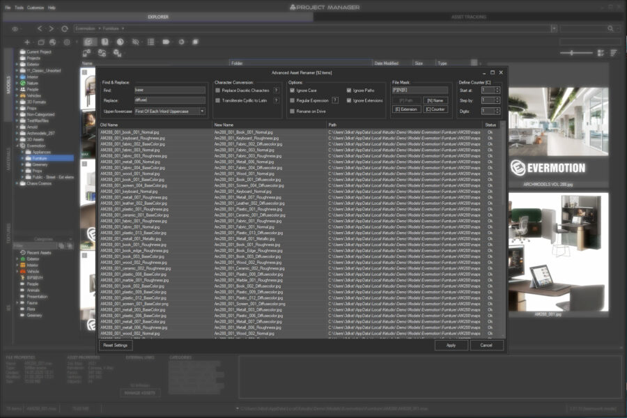

Advanced Asset Renamer allows you to rename selected files using different masks.
Project Manager - 3D Asset Browser - Advanced Asset Renamer
Note that you can immediately see the name that is to be assigned to your file.
Here I`d like to point out that if you run the tool in the Explorer tab, it will work with the files on your hard drive. In the Asset Files tab, you can work with links to textures, IES, and other assets used in the scene.
When the Rename on Hard Drive box is checked, the tool will rename both the links and the actual files on your hard drive.
Please note that renaming your files may affect the links to these files in other scenes. In order to avoid this problem, first, copy your files to the project folder and only then go on to rename them.

Find&Replace tab
In the Find field, enter your search query, and in the Replace field, specify what to replace it with.
The Upper/lowercase parameter lets you control the letter case: you can leave it as it is or convert the file name to lowercase or uppercase.
You can also capitalize the first letter of the first word or the first letters of every word in the name.
Options tab
Regular Expression
If necessary, you can use regular expressions for renaming.
Regular expressions allow setting complex patterns for search and replace operations. You can find an overview of regular expressions on Wikipedia.
The tool shows the name to be assigned to your file then and there so that you can see the result before actually renaming your files and links. Which is rather convenient. Regular expressions are a separate subject to study.
This option allows renaming not only the links but the actual files on the hard drive. The Ignore Extensions option is very useful in the case when changing filenames can mess up file extensions.
Let`s take the texture file “jpg wood_92_reflect.jpg” as an example. Deleting the “jpg” part of the name removes the extension of the file.
Activating the Ignore Extensions option allows you to change only the name of the file without altering its extension.
The Ignore Paths option is available only from the Asset Files tab and only when the Rename on Hard Drive option is off.
