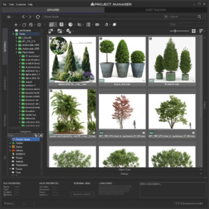

What it does
Imports the chosen models from Project Manager directly into your scene.
Creates a new Forest object if the current selection is not a Forest, otherwise adds the assets to the selected Forest.
Adds the imported models to the Forest object’s Geometry list.
Optionally assigns your selected surfaces/splines to the Forest object’s Surface/Areas for distribution.

Typical workflow
Select a Forest object or select scene objects you want to use as surfaces.
In Project Manager, select the model files to scatter.
Run Forest Pack Bridge (button/hotkey).
Confirm surfaces/areas if prompted, then fine-tune your Forest settings as usual.
