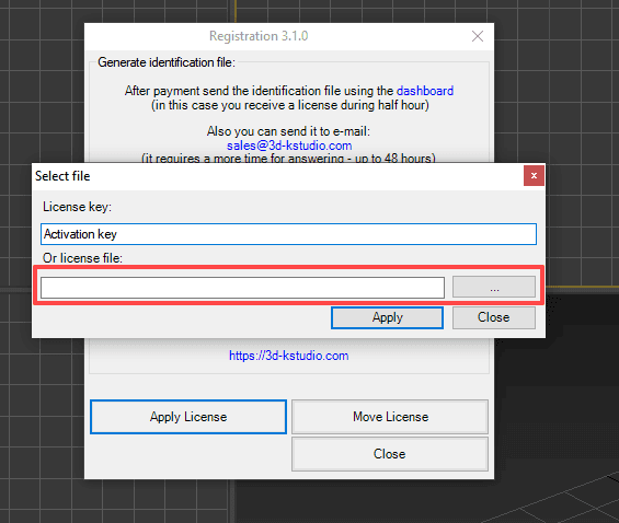

Insert the activation key received in the letter and click the button “Apply License”
Note: Internet connection is required to use activation keys
If you have a problem with this activation type, use the second method – using identification file
You can use a single identification file to obtain licenses for various plugins.
For instance, you can generate an identification file for Sweep PRO and use it also in the slot for generating a license for Spline Flow
1. Press the button “Generate identification file”
2. Login to dashboard using the same email you used for purchase
3. Upload the identification file, generated in the previous step, by pressing the “Choose File” button
4. Press the button “Send”
5. Download the license key from the dashboard.
Also, you will receive a copy of your license key to an email-box
6. Press the button “Apply License” and choose the downloaded license key
