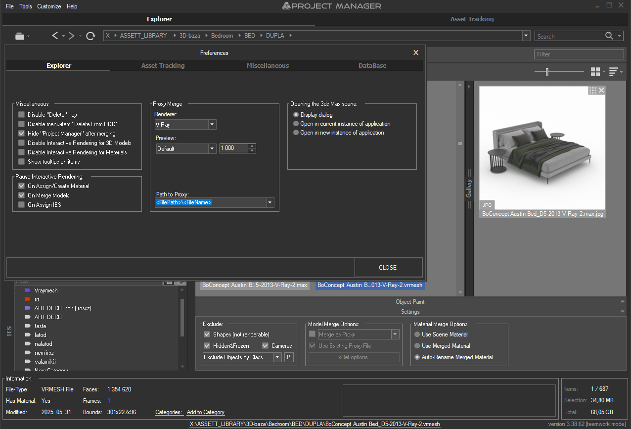

  • #44955
    Posts: 13
    Threads: 27
    • #44956
      Posts: 13
      Threads: 27
        There is no connection between the files, if the batch export gets stuck and I restart it, it will also transfer the file where it got stuck without any problems. So I don’t see the point in sending the file, because it would be a distraction. But if it helps, I can send the log file after the export got stuck, if that helps and shows the actual processes.

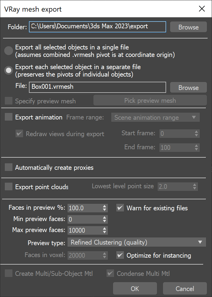

    • #44958
      Posts: 263
      Threads: 1239
        I mean this dialog or analog for Corona/Arnold
